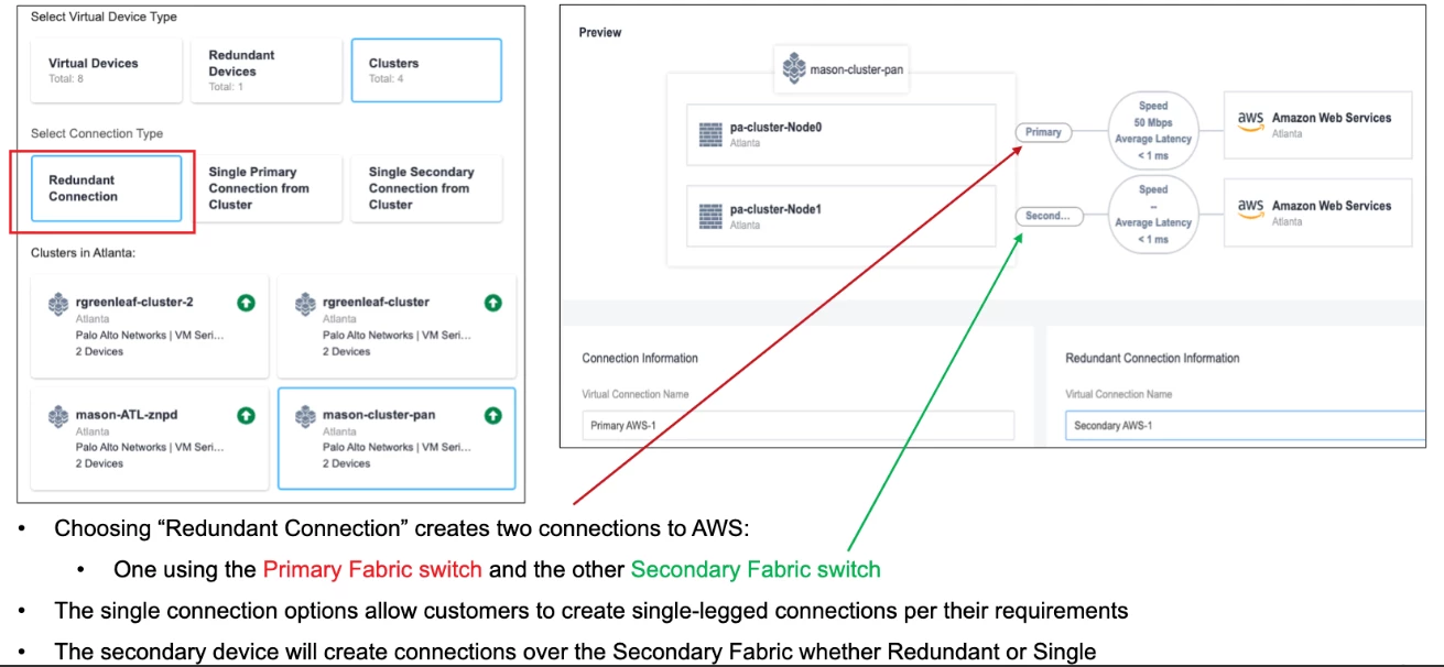

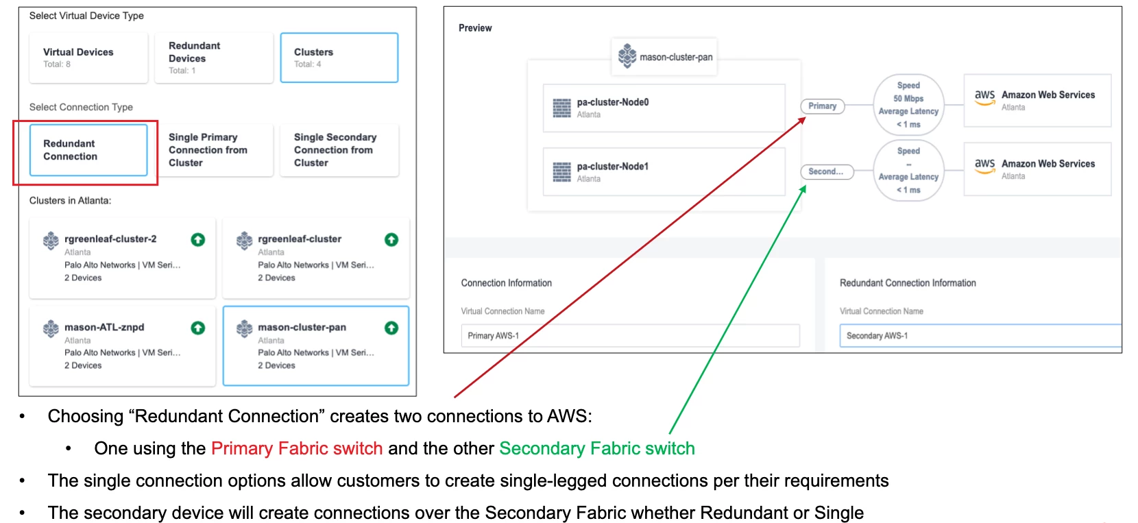

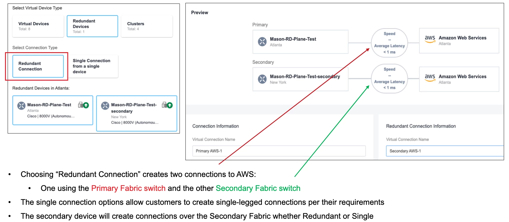

  • Virtual connections allow NE devices to connect to CSPs, NSPs and ISPs as well as co-location​
  • The same logic still applies: the NE device plane determines which Fabric switch is used​
  • The VC connection workflow is very similar to the EVP-LAN workflow with some differences​
  • Customers that require VC link resiliency should create two or more VCs to their NE devices with each connection traversing the Primary and Secondary fabric switch​
  • Some CSPs like Azure require resiliency but most do not​
  • The Fabric portal allows connections to be created as redundant or single-legged​
  • The workflow is highlighted in the next few slides for both Redundant and Clustered devices
