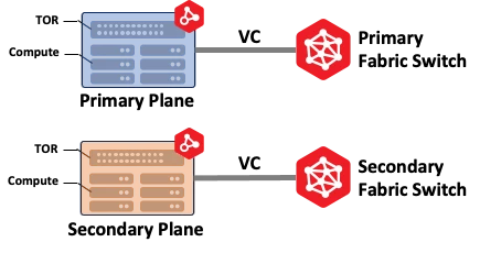

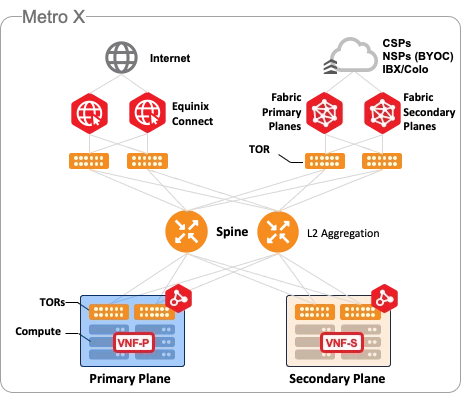

Network Edge is built upon a standard data center redundancy architecture with multiple pods that have dedicated power supplies and a dedicated Top of Rack (ToR) switch.
  • It consists of multiple compute planes commonly referred to as Plane A and Plane B for design simplicity
  • Plane A connects to the Primary Fabric network and Plane B connects to the Secondary Fabric network
The most important concept for understanding Network Edge resiliency: the device plane determines which Fabric switch is used for device connections. Future posts will dive much deeper in the various ways that Network Edge devices connect to other devices, Clouds and co-location.
  • While referred to as Plane A and Plane B, in reality there are multiple compute planes in each NE pod
  • The actual number varies based on the size of the metro
  • This allows devices to be deployed in a manner where they are not co-mingled on the same compute plane, eliminating compute as a single point of failure

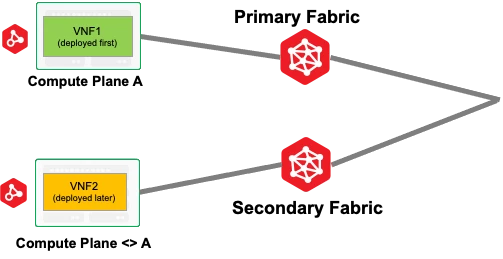

  • Single devices can convert to Redundant Devices via the anti-affinity feature
Anti-Affinity Deployment Option
  • By default single devices have no resiliency

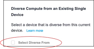

  • However, single devices can be placed in divergent compute planes. This is commonly called anti-affinity and is part of the device creation workflow
  • Checking the "Select Diverse From" box allows customers to add new devices that are resilient to each other
  • Customers can verify this by viewing their NE Admin Dashboard and sorting their devices by "Plane"
  • This feature allows customer to convert a single device install to Redundant Devices
  • By default, the first single device was deployed on the Primary Fabric
  • The actual compute plane is irrelevant until the 2nd device is provisioned
  • The 2nd device is deployed on the Secondary Fabric AND in a different compute plane than the first device

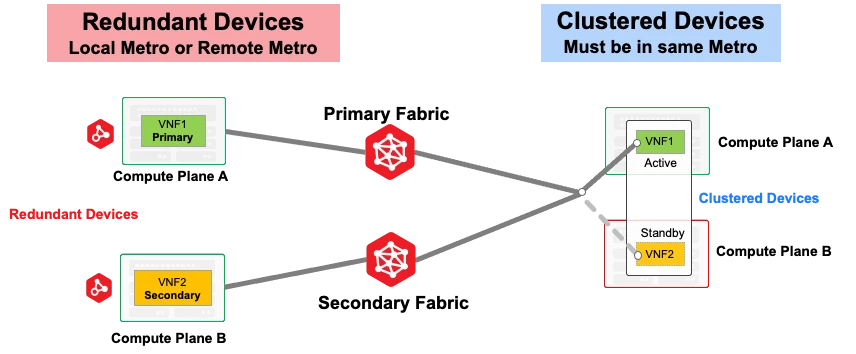

Resilient Device Options
  • These options provide local (intra-metro) resiliency to protect against hardware or power failures in the local Network Edge pod
  • By default, the two virtual devices are deployed in separate compute planes (A and B)
  • In reality there are more than two compute planes, but they are distinct from each other
  • The primary device is connected to the Primary Fabric network and the secondary/passive device is connected to the Secondary Fabric network

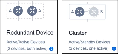

Redundant Devices
Clustered Devices
Deployment
Two devices, both Active, appearing as two devices in the Network Edge portal. Both devices have all interfaces forwarding
Two devices, only one is ever Active. The Passive (non-Active) device data plane is not forwarding
WAN Management
Both devices get a unique L3 address that is active for WAN management
Each node gets a unique L3 address for WAN management as well as a Cluster address that connects to the active node (either 0 or 1)
Device Linking Groups
None are created at device inception
Two are created by default to share config synchronization and failover communication
Fabric Virtual Connections
Connections can be built to one or both devices
Single connections are built to a special VNI that connects to the Active Cluster node only. Customer can create optional, additional secondary connection(s)
Supports Geo-Redundancy ?
Yes, Redundant devices can be deployed in different metros
No, Clustered devices can only be deployed in the same metro
Vendor Support
All Vendors
Fortinet, Juniper, NGINX and Palo Alto
