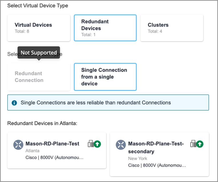

Redundant Devices
  • For proper resiliency, each device in the Redundant Device pair will require a single connection to two different EVP-Networks​
  • The Primary device on the Primary plane will use the Primary Fabric switch​
  • The Secondary device on the Secondary plane will use the Secondary Fabric switch​

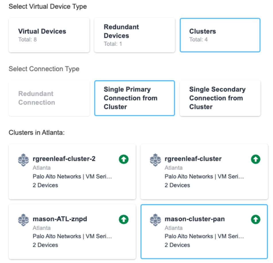

Clustered Devices
  • Clustered devices are different in that the workflow allows connections to be built to either the Primary or Secondary Fabric​
  • For proper resiliency, each node in the Cluster will require a single connection to two different EVP-Networks​
