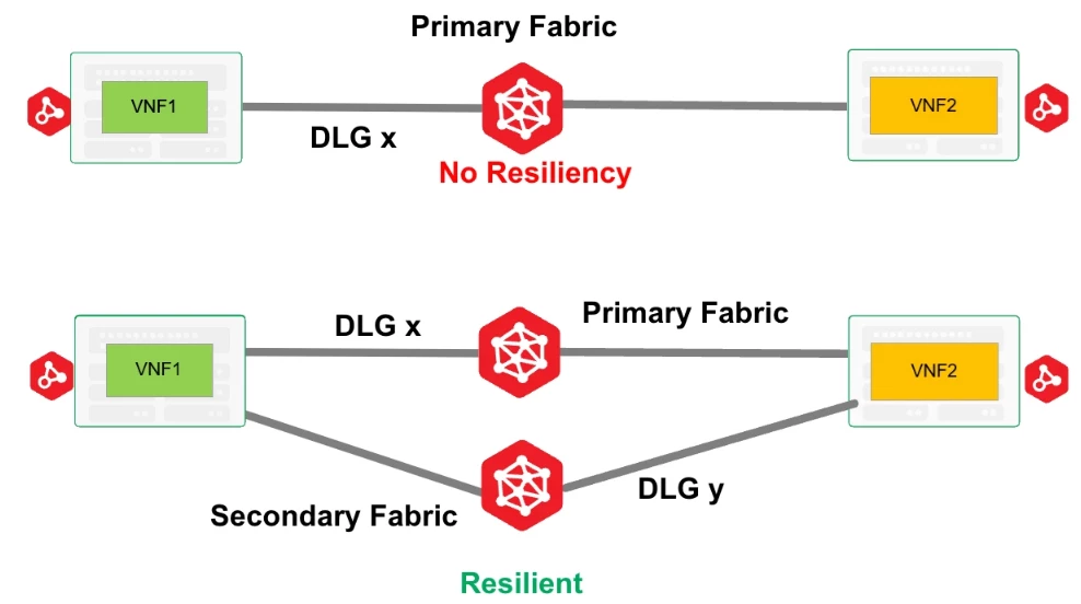

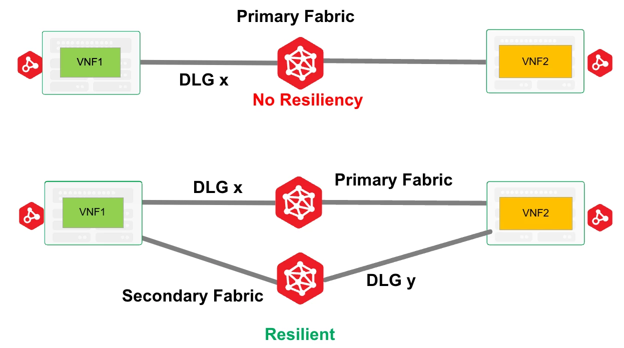

  • A single DLG, like a single Ethernet cable, provides no resiliency​
  • Local DLGs do not traverse the Equinix Fabric and aren’t susceptible to Fabric switch outages ​
  • Hybrid DLGs have some devices connected to the Primary Fabric plane and other to the Secondary​
  • Customers that require maximum resiliency should deploy additional DLGs that connect to both the Primary and Secondary Fabric networks​

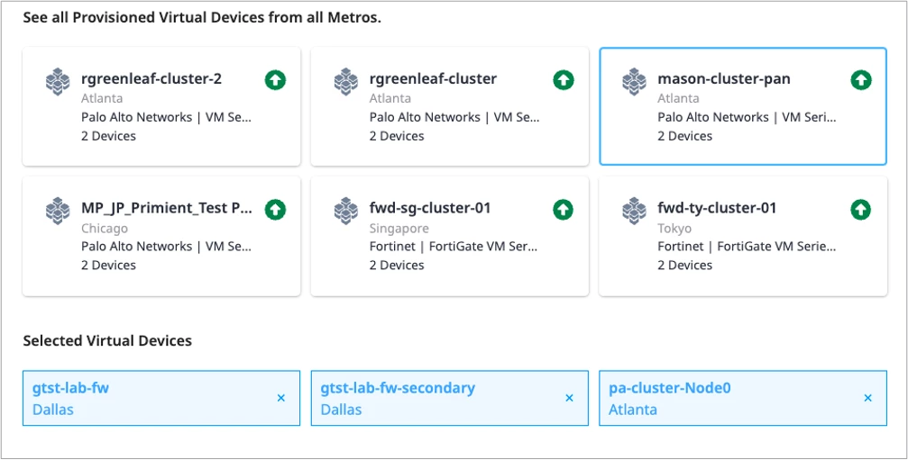

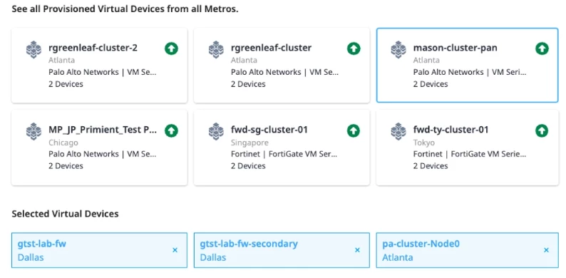

  • Redundant Devices can have one or both devices connect to the DLG​
  • Clustered devices act as one logical device, therefore the cluster is represented as a single entity​
Each device will build connections to the Plane to which it is connected as shown here:
  • Redundant Devices show as individual entities in the DLG workflow​
  • Clustered Devices are represented as a single logical entity, connecting the DLG to the active node (node 0 is active by default)​

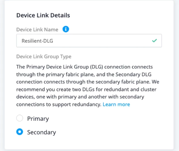

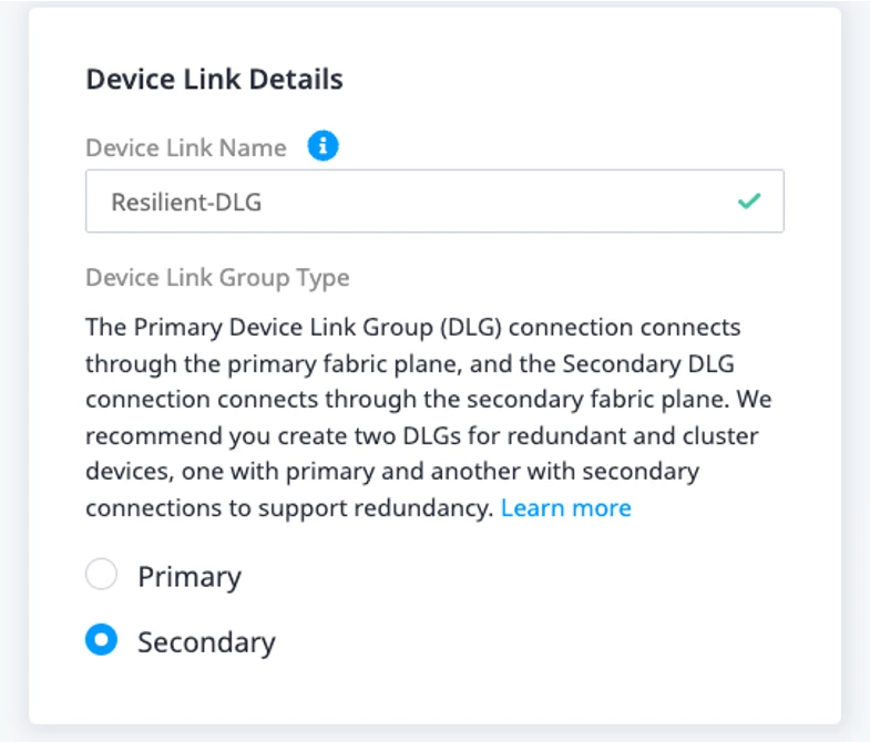

  • In October 2023 a new feature was released that allows customers to choose which Fabric plane the DLG is connected to: Primary or Secondary​
  • Previously, all connections were made over the Primary Fabric plane by default​
  • Customers now have control over the level of resiliency for their DLGs. Single DLGs will have no resiliency but customers may opt to deploy a 2nd, parallel DLG for connections that are business-critical.​
  • The 2nd DLG will incur additional Fabric charges and will consume an additional interface on every connected Network Edge device​
  • We do not see value in creating multiple, local (same metro) DLGs for resiliency, but we do not restrict customers who want to deploy in this manner​
  • Local DLGs do not traverse the Fabric switches and incur no charges today​
  • Customers now have the control to deploy resiliency with DLGs based on their requirements and budget as shown below​
