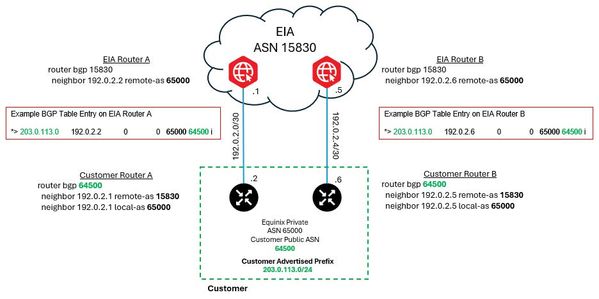

The picture below provides only the relevant configuration snippets needed to convey the concept of using BGP Local-AS. It's presented using classic, non Address Family Cisco configuration syntax. An explanation of the relevant configuration variables and commands are explained below the picture. This short post is only intended to help readers understand how local-as can be used with EIAoF and is not intended to represent a complete BGP configuration nor an in-depth overview of local-as capabilities.
Figure 1 – BGP Local-AS Example

A Side Key Configuration Command References
router bgp 64500 ⬅️ Customer’s public ASN
Customer router BGP ASN. This is the ASN BGP speakers use for peering (when not using local-as.)
neighbor 192.0.2.1 remote-as 15830 ⬅️ EIA public ASN
Defines the BGP connection to the EIA edge gateway router.
neighbor 192.0.2.1 local-as 65000 ⬅️ Equinix Assigned Private ASN
This makes the EIA edge gateway see this peer as belonging to the private AS 65000 instead of 64500. This router will also prepend AS 65000 to all updates sent to the EIA edge gateway.
EIA Edge Gateway Router A
*> 203.0.113.0 192.0.2.2 0 0 65000 64500 i
The output above is an excerpt from the BGP table on the example EIA router A edge gateway. The fact this prefix appears in the BGP table with the associated ASNs confirms successful peering between EIA and the customer router using AS 65000. You can also see the AS-PATH of the prefix received lists the customer’s real AS, 64500, as the origination AS with the private ASN, 65000, prepended to it.
When EIA advertises this prefix to external peers it will strip the private ASN, 65000, and prepend 15830 in its place. This will result in external peers seeing the 203.0.113.0/24 prefix with an AS-PATH of 15830 64500.
