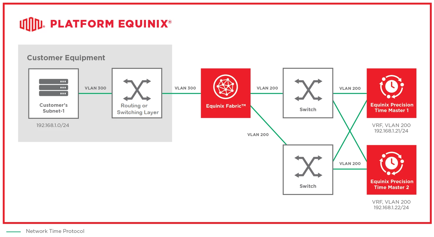

Can I build redundancy across two ports for Fabric and Precision Time?
Can I build redundancy across two ports such that Equinix Fabric Port A goes to Timing Master 1, and Equinix Fabric Port B goes to Timing Master 2?
Answer
Mar 25, 2022 6:33 PM UTC
No, a single connection always goes to both master time servers:
When you select the Fabric Port redundancy option, your configuration will have redundant Fabric Virtual connections. Each connection connects to same two timing masters.
1 reply

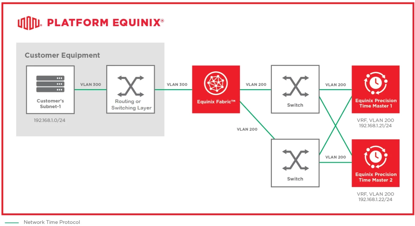

Answer
