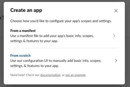

1. Create a Channel in Slack
2. Create a Slack App for Incoming Webhooks

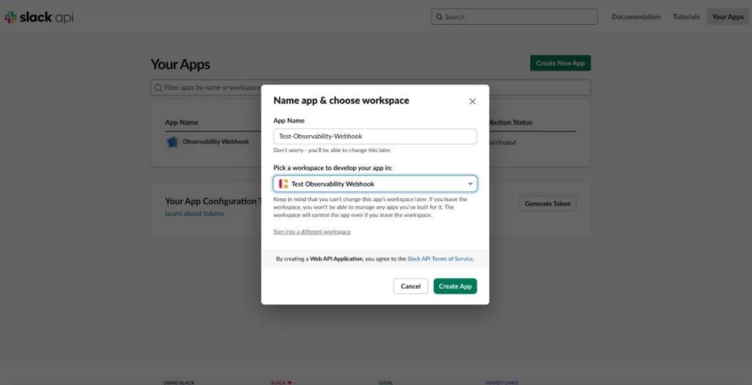

2.1 Name the App
  • App Name: Enter a name for the incoming Webhook App.
2.2 Pick a workspace to develop your app in
  • Workspace: Select the Slack Workspace for the Incoming Webhook App.

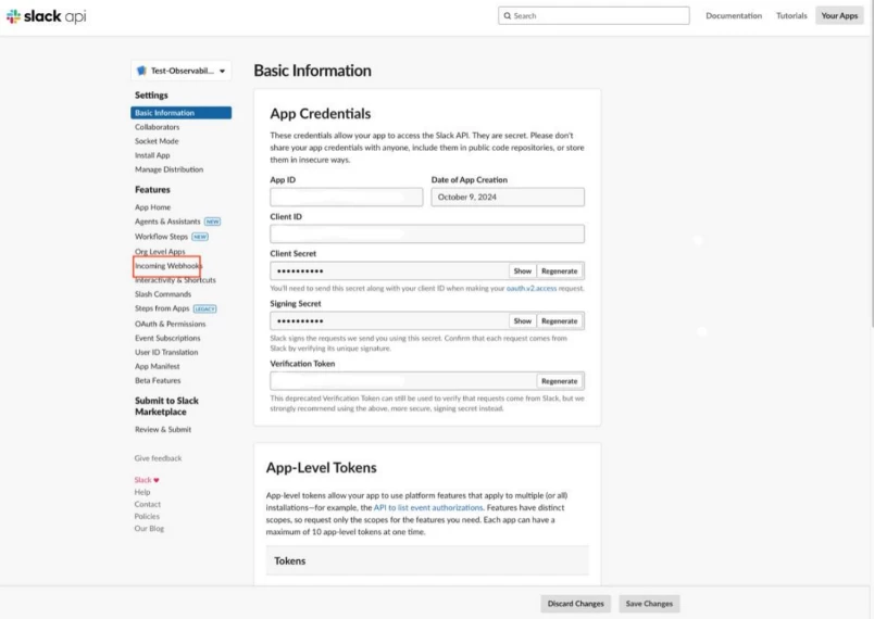

3.1 Navigate to the Incoming Webhooks
  • After creating an app, you are redirected to Basic Information Under the setting section.
  • Navigate to Incoming Webhooks under the Feature Section on the left navigation.

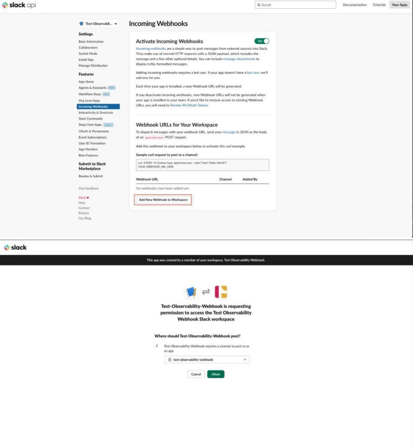

3.2 Configure the Incoming Webhooks
  • Toggle on Active Incoming Webhooks
  • Select Add New Webhook to Workspace
  • Select the channel to enable the Incoming Webhooks then click allow.

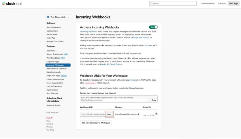

4. Save the Slack Webhook URL
  • Ensure that URL generated during this process are saved securely. The URL is required for further integration or data ingestion processes.
4.1 Copy the Webook URL
  • Once the setup is complete, a URL value will be generated.
  • Copy this URL to your clipboard, as it will be needed later for the POST streamSubscription API in Stream Observability.

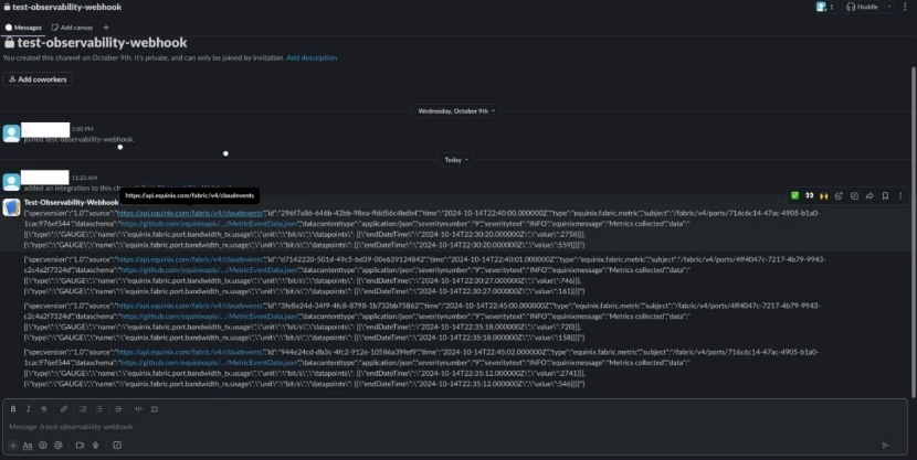

4.2 Start receiving Fabric events and metrics in the Slack Channel
