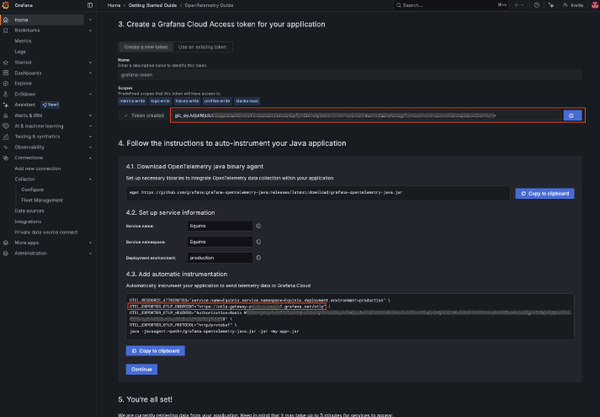

1. Create a New Connection using OpenTelemetry
  • Refer to Grafana Doc Recommended OpenTelemetry setup via Grafana Cloud integrations
  • Sign In to the Grafana Cloud Portal.
  • From your organization “Overview”, select or click Launch to open a Grafana Cloud stack.
  • With a stack selected, click “ Launch” from the Grafana tile to launch Grafana Cloud.

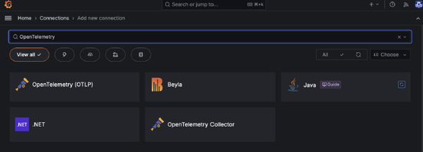

  • With Grafana Cloud launched, click “Connections”, or expand, then click “Add new connection”.
  • Search for “OpenTelemetry” and press enter to filter the connection options.
  • Select the desired OpenTelemetry connection tile and follow the instructions.
1.1 Provide a token name under “Access Policy Token Name”
  •  Access Policy Token Name: Provide a token name to identify the connection
1.2 Enter “Equinix” for the Service Name and Namespace under “Set up service information”
  •  Service Name: Provide “Equinix” as the value
  • Service Namespace: Provide “Equinix” as the value
1.3 Save the token and OTLP Endpoint for Subscription Request
  •  Ensure that the token and OTEL_EXPORTER_OTLP_ENDPOINT values during this process are saved securely. The token and OTEL_EXPORTER_OTLP_ENDPOINT are required for further integration or data ingestion processes.

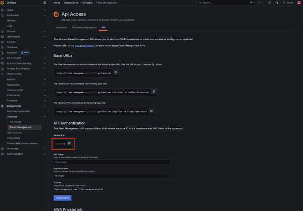

2. Save the Grafana Instance ID
  • From your organization Overview, select or click Launch to open a Grafana Cloud stack.
  • With Grafana Cloud launched, click connections, or expand, then click Collector.
  • With Collector expanded, click Fleet Management.
3. Copy the Token, Grafana Endpoint, and Instance Id to create Grafana Subscription
  • Once the setup is complete, the values will be generated.
  • Copy the URL to your clipboard, as it will be needed for the POST subscription API in Stream Observability.

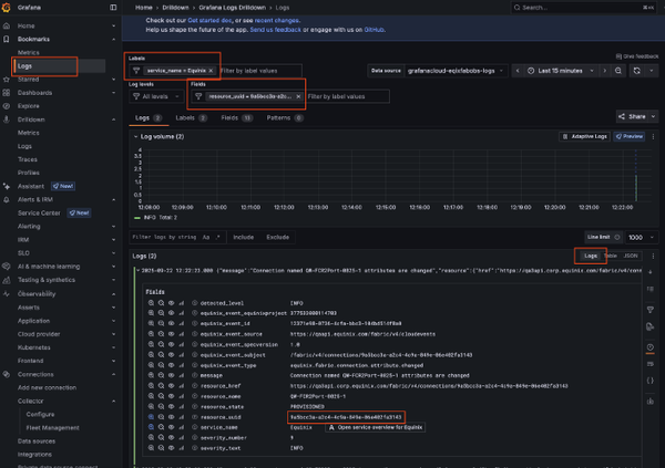

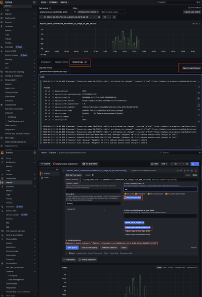

4. Start receiving Fabric Events (logs) in Grafana
  • Go to "Logs" on left navigation
  • In the Labels Search Bar, search by "service_name = Equinix".
  • You can filter your events by resource ID by adding a filter under "Fields":
  • Click on a suggested "resource_uuid"
  • Paste the UUID to search the log/event

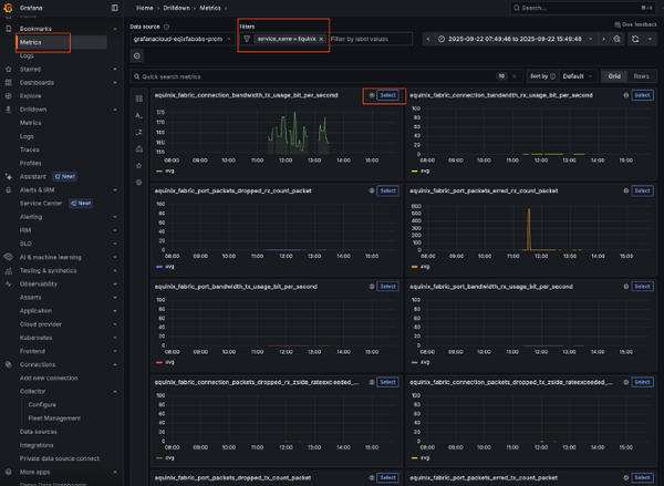

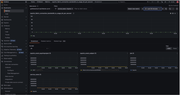

5. Start receiving Fabric Metrics in Grafana
  • Go to metrics on the left navigation
  • In the Labels Search Bar Search by "service_name = Equinix"
  • Select a Metric Type

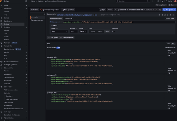

5.1 Search Metrics for specific assets under Explore Page
  • On the “Breakdown” Tab, the “equinix_event_subject” will contain the
    uuid(s) of the connection or port when metric data points are received.
    Click on the subject to return only the metric’s of single uuid

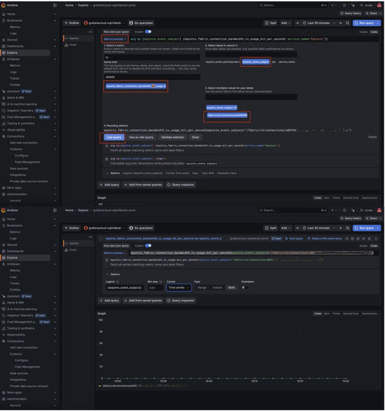

  • Alternatively, search on a metric through the Explore Page
    • Click on the “Explore” Page
    • Expand “Metrics browser”
    • Under “Select a Metric”, suggested metrics name will appear
    • Click on the metric name you are looking for.
    • Under “Select labels to search in”, click “equinix_event_subject”
    • Under “Select [multiple] values for your labels”, click on the asset’s uuid for the metric that you are looking for
    • Click the “Use query” Button, and the metrics are returned specifically for the asset uuid

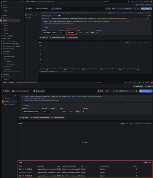

5.2 View OpenTelemetry Metric Messages for specific assets under Explore Page
  • Expand "Options"
  • Change the format to "Table"
  • Click "Expand Results" Toggle
