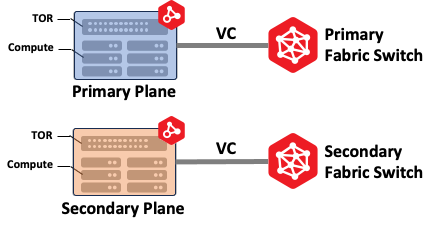

Network Edge is built upon a standard data center redundancy architecture with multiple pods that have dedicated power supplies and a dedicated Top of Rack (ToR) switch.
  • It consists of multiple compute planes commonly referred to as Plane A and Plane B for design simplicity
  • Plane A connects to the Primary Fabric network and Plane B connects to the Secondary Fabric network
The most important concept for understanding Network Edge resiliency: the device plane determines which Fabric switch is used for device connections. Future posts will dive much deeper in the various ways that Network Edge devices connect to other devices, Clouds and co-location.
  • While referred to as Plane A and Plane B, in reality there are multiple compute planes in each NE pod
  • The actual number varies based on the size of the metro
  • This allows devices to be deployed in a manner where they are not co-mingled on the same compute plane, eliminating compute as a single point of failure

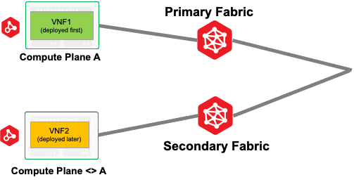

Single Devices
  • Single devices have no resiliency for compute and device failures
  • The first single device is always connected to the Primary Compute Plane *
  • Single devices always make connections over the Primary Fabric network
  • Single devices can convert to Redundant Devices via the anti-affinity feature

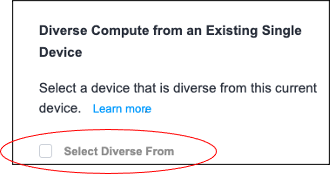

Anti-Affinity Deployment Option
  • By default single devices have no resiliency
  • However, single devices can be placed in divergent compute planes. This is commonly called anti-affinity and is part of the device creation workflow
  • Checking the "Select Diverse From" box allows customers to add new devices that are resilient to each other
  • Customers can verify this by viewing their NE Admin Dashboard and sorting their devices by "Plane"
  • This feature allows customer to convert a single device install to Redundant Devices
  • By default, the first single device was deployed on the Primary Fabric
  • The actual compute plane is irrelevant until the 2nd device is provisioned
  • The 2nd device is deployed on the Secondary Fabric AND in a different compute plane than the first device

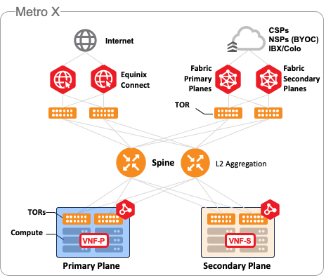

Resilient Device Options
  • These options provide local (intra-metro) resiliency to protect against hardware or power failures in the local Network Edge pod
  • By default, the two virtual devices are deployed in separate compute planes (A and B)
  • In reality there are more than two compute planes, but they are distinct from each other
  • The primary device is connected to the Primary Fabric network and the secondary/passive device is connected to the Secondary Fabric network
